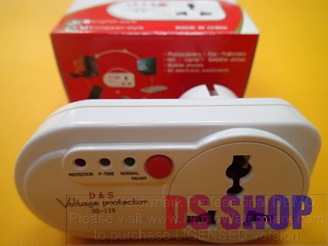

PS. I got something called
D&S voltage protector a while ago. It didn't help.
